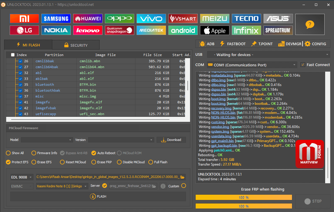

sharifi8 ارسال شده در 24 اردیبهشت، ۱۴۰۲ اشتراک گذاری ارسال شده در 24 اردیبهشت، ۱۴۰۲ آموزش ترمیم سریال Redmi Note 8 از آموزشگاه آناتل مرحله اول:مقاومت RSA رو جابه جا کنید مرحله دوم: reset efs Code: [EDL] WIPE EFS Selected Model : Xiaomi Redmi Note 8 [2] Code Name : Ginkgo [2] Operation : Wipe EFS [1] Authenticating... OK Retrieving data... OK [4.35 MiB] Initializing data... OK Waiting for HS-USB QDLoader 9008... COM57 Connecting to device... OK Handshaking... OK Reading bootloader info... OK Serial : 2601599265 SoC : [Snapdragon 665] [SDM665] [0x0010A0E1] OEM : Xiaomi [0x0072] Model : Unknown [0x0000] PK_HASH[0] : 1BEBE3863A6781DB4B01086063007334 PK_HASH[1] : DE9E5CA14971C7C4F4358EC9D79CDA46 Writing flash programmer... OK Connecting to flash programmer... OK Configuring device... OK Firehose config : eMMC [Sector:512] [Target:0] [Host:16384] Reading partition map... OK - LU Count : 1 Reading software info... OK Model Name : Redmi Note 8 Product Name : ginkgo Manufacturer : Xiaomi Platform : ginkgo Android Version : 10 Security Patch : 2021-01-01 Build : V12.0.2.0.QCOINXM Build Date : Wed Jan 20 23:23:24 WIB 2021 MIUI Version : V12 MIUI Build : V12.0.2.0.QCOINXM MIUI Region : in MIUI Locale : en-GB Backing up EFS... OK Finalizing... OK Saved to : C:\UnlockTool\Backups\EFS\efs_2023-01-26_19-24-04.efs Wiping EFS... OK Total sector : 4096 Rebooting... OK UNLOCKTOOL 2023.01.13.1 Elapsed time : 16 seconds مرحله سوم: engineer Firmwareرایت کنید Selected Model : Xiaomi Redmi Note 8 [1] Code Name : Ginkgo [1] Operation : Auth Flash Authenticating... OK Retrieving data... OK [507.87 KiB] Initializing data... OK Waiting for HS-USB QDLoader 9008... COM57 Connecting to device... OK Handshaking... OK Reading bootloader info... OK Serial : 2601599265 SoC : [Snapdragon 665] [SDM665] [0x0010A0E1] OEM : Xiaomi [0x0072] Model : Unknown [0x0000] PK_HASH[0] : 1BEBE3863A6781DB4B01086063007334 PK_HASH[1] : DE9E5CA14971C7C4F4358EC9D79CDA46 Writing flash programmer... OK Connecting to flash programmer... OK Configuring device... OK Firehose config : eMMC [Sector:512] [Target:0] [Host:16384] Processing LUN0 - rawprogram_unsparse.xml Writing sec.elf [elf:12.46 KiB]->secdata... OK 0.201s Writing qupv3fw.elf [elf:48.05 KiB]->qupfw... OK 0.107s Writing qupv3fw.elf [elf:48.05 KiB]->qupfwbak... OK 0.105s Writing vbmeta.img [raw:4 KiB]->vbmeta... OK 0.102s Writing vbmeta.img [raw:4 KiB]->vbmetabak... OK 0.101s Writing xbl_config.elf [elf:48.06 KiB]->xbl_config... OK 0.104s Writing xbl_config.elf [elf:48.06 KiB]->xbl_configbak... OK 0.104s Writing devcfg.mbn [elf:41.73 KiB]->devcfg... OK 0.103s Writing devcfg.mbn [elf:41.73 KiB]->devcfgbak... OK 0.103s Writing storsec.mbn [elf:20 KiB]->storsec... OK 0.102s Writing rpm.mbn [elf:215.16 KiB]->rpm... OK 0.111s Writing rpm.mbn [elf:215.16 KiB]->rpmbak... OK 0.108s Writing hyp.mbn [elf:361.13 KiB]->hyp... OK 0.116s Writing hyp.mbn [elf:361.13 KiB]->hypbak... OK 0.112s Writing km4.mbn [elf:232.48 KiB]->keymaster... OK 0.114s Writing km4.mbn [elf:232.48 KiB]->keymasterbak... OK 0.109s Writing cmnlib.mbn [elf:384.41 KiB]->cmnlib... OK 0.118s Writing cmnlib64.mbn [elf:499.5 KiB]->cmnlib64... OK 0.121s Writing cmnlib.mbn [elf:384.41 KiB]->cmnlibbak... OK 0.119s Writing cmnlib64.mbn [elf:499.5 KiB]->cmnlib64bak... OK 0.119s Writing abl.elf [elf:204 KiB]->abl... OK 0.107s Writing abl.elf [elf:204 KiB]->ablbak... OK 0.108s Writing BTFM.bin [fat:876 KiB]->bluetooth... OK 0.138s Writing BTFM.bin [fat:876 KiB]->bluetoothbak... OK 0.134s Writing misc.img [raw:85 bytes]->misc... OK 0.102s Writing imagefv.elf [elf:20 KiB]->imagefv... OK 0.102s Writing imagefv.elf [elf:20 KiB]->imagefvbak... OK 0.102s Writing uefi_sec.mbn [elf:125.76 KiB]->uefisecapp... OK 0.106s Writing uefi_sec.mbn [elf:125.76 KiB]->uefisecappbak... OK 0.105s Writing xbl.elf [elf:2.86 MiB]->xbl... OK 0.196s Writing xbl.elf [elf:2.86 MiB]->xblbak... OK 0.213s Writing tz.mbn [elf:1.93 MiB]->tz... OK 0.175s Writing tz.mbn [elf:1.93 MiB]->tzbak... OK 0.177s Writing devinfo.img [raw:1 MiB]->devinfo... OK 0.139s Writing logfs_ufs_8mb.bin [fat:16 KiB]->logfs... OK 0.101s Writing metadata_1.img [ext4:36 KiB]->metadata... OK 0.102s Writing metadata_2.img [raw:4 KiB]->metadata... OK 0.101s Writing metadata_3.img [raw:4 KiB]->metadata... OK 0.101s Writing metadata_4.img [raw:4 KiB]->metadata... OK 0.102s Writing dtbo.img [raw:8 MiB]->dtbo... OK 0.377s Writing dtbo.img [raw:8 MiB]->dtbobak... OK 0.364s Writing dspso.bin [ext4:32 MiB]->dsp... OK 1.304s Writing dspso.bin [ext4:32 MiB]->dspbak... OK 1.197s Writing persist.img [ext4:32 MiB]->persist... OK 1.289s Writing persist.img [ext4:32 MiB]->persistbak... OK 1.223s Writing boot.img [kernel:64 MiB]->boot... OK 2.267s Writing boot.img [kernel:64 MiB]->bootbak... OK 2.253s Writing recovery.img [kernel:64 MiB]->recovery... OK 2.274s Writing NON-HLOS.bin [fat:111.92 MiB]->modem... OK 3.912s Writing NON-HLOS.bin [fat:111.92 MiB]->modembak... OK 4.105s Writing vendor_1.img [ext4:400 KiB]->vendor... OK 0.117s Writing vendor_2.img [raw:8 KiB]->vendor... OK 0.102s Writing vendor_3.img [raw:624 KiB]->vendor... OK 0.128s Writing vendor_4.img [raw:103.91 MiB]->vendor... OK 3.888s Writing vendor_5.img [raw:255.63 MiB]->vendor... OK 8.895s Writing vendor_6.img [raw:77.6 MiB]->vendor... OK 2.761s Writing vendor_7.img [raw:8 KiB]->vendor... OK 0.101s Writing vendor_8.img [raw:8 KiB]->vendor... OK 0.100s Writing vendor_9.img [raw:8 KiB]->vendor... OK 0.101s Writing vendor_10.img [raw:23.96 MiB]->vendor... OK 1.128s Writing vendor_11.img [raw:4 KiB]->vendor... OK 0.101s Writing system_1.img [ext4:1.16 MiB]->system... OK 0.151s Writing system_2.img [raw:4 KiB]->system... OK 0.101s Writing system_3.img [raw:1.17 MiB]->system... OK 0.154s Writing system_4.img [raw:95.27 MiB]->system... OK 3.366s Writing system_5.img [raw:254.89 MiB]->system... OK 9.164s Writing system_6.img [raw:254.89 MiB]->system... OK 9.267s Writing system_7.img [raw:254.89 MiB]->system... OK 8.918s Writing system_8.img [raw:254.89 MiB]->system... OK 9.087s Writing system_9.img [raw:301.06 MiB]->system... OK 10.331s Writing system_10.img [raw:4 KiB]->system... OK 0.102s Writing system_11.img [raw:8 KiB]->system... OK 0.052s Writing system_12.img [raw:8 KiB]->system... OK 0.101s Writing system_13.img [raw:16 KiB]->system... OK 0.101s Writing system_14.img [raw:71.86 MiB]->system... OK 2.528s Writing system_15.img [raw:4 KiB]->system... OK 0.101s Writing userdata_1.img [raw:8 KiB]->userdata... OK 0.101s Writing userdata_2.img [raw:32 KiB]->userdata... OK 0.101s Writing userdata_3.img [raw:8 KiB]->userdata... OK 0.101s Writing userdata_4.img [raw:4 KiB]->userdata... OK 0.101s Writing userdata_5.img [raw:372 KiB]->userdata... OK 0.114s Writing userdata_6.img [raw:4 KiB]->userdata... OK 0.101s Writing userdata_7.img [raw:24 KiB]->userdata... OK 0.102s Writing userdata_8.img [raw:4 KiB]->userdata... OK 0.102s Writing userdata_9.img [raw:4 KiB]->userdata... OK 0.100s Writing userdata_10.img [raw:112 KiB]->userdata... OK 0.105s Writing userdata_11.img [raw:76 KiB]->userdata... OK 0.106s Writing userdata_12.img [elf:1.23 MiB]->userdata... OK 0.154s Writing gpt_main0.bin [raw:17 KiB]->PrimaryGPT... OK 0.101s Writing gpt_backup0.bin [raw:16.5 KiB]->BackupGPT... OK 0.101s Applying patch0.xml... OK Rebooting... OK Total transfer : 2.47 GiB Transfer Speed : 25.86 MiB/s UNLOCKTOOL 2023.01.13.1 Elapsed time : 1 minute 54 seconds مرحله چهارم: ENG QCN رو با برنامه qfil رایت کنید مرحله پنجم سیم یک و دو رو با umt ترمیم سریال بزنید(بعد از اینکه فایل qcnرو با qfil رایت کردین) مرحله ششم: Stock Firmware رایت کنید نقل قول لینک به دیدگاه به اشتراک گذاری در سایت های دیگر More sharing options...
